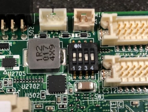

Set Boot Switch to SD Card Mode
- Check the SW1 1 and 2 on

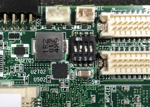

After Flashing, Remove SD Card and Set Boot Switch to eMMC Mode
- Check the SW1 2 on
